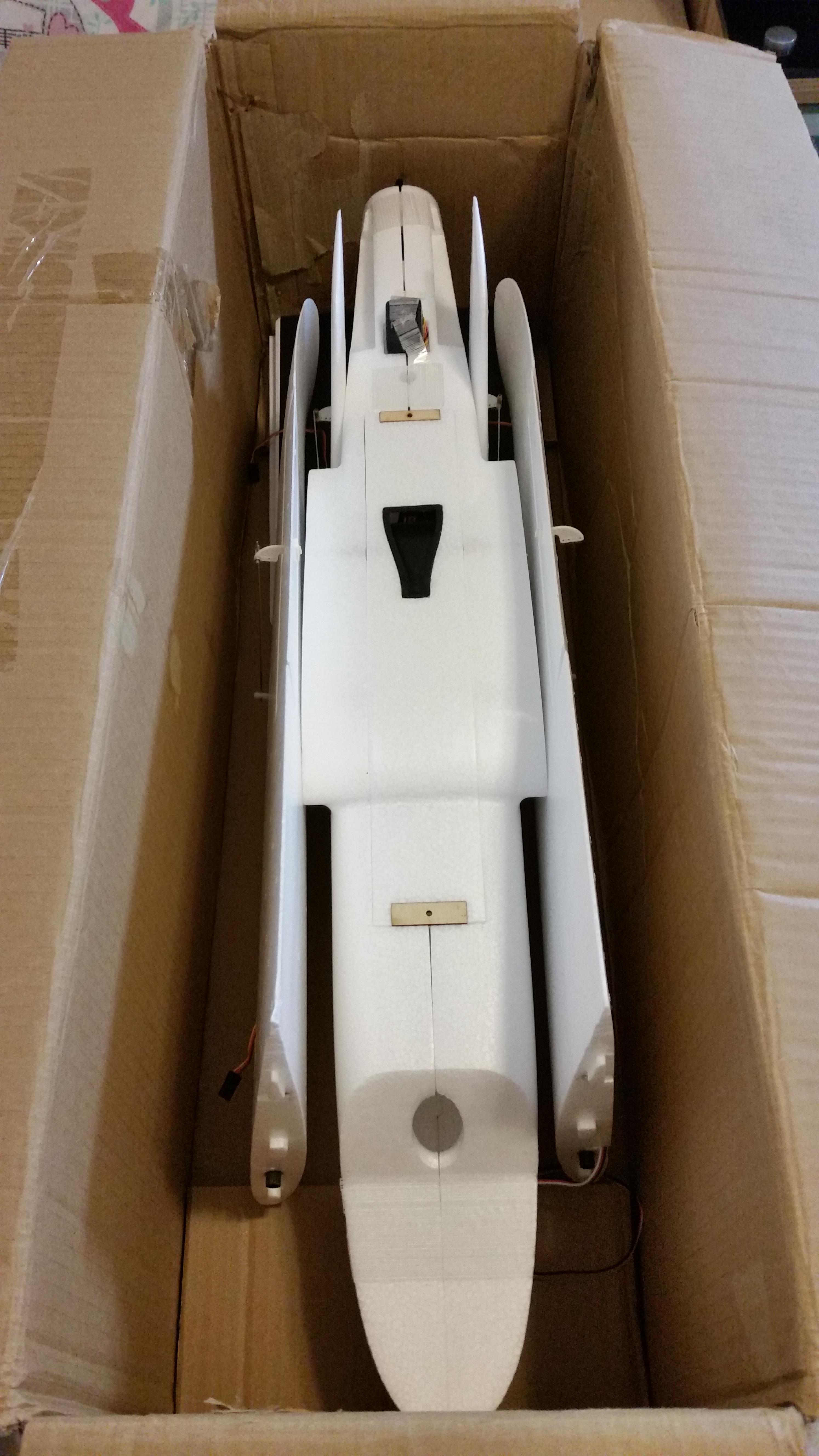

- maio 31, 2017 às 3:40 pm
Ola pessoalDesenterrando o tópico, Como está o talon de vocês? Estou montando um com essa configuração:
Mini Talon http://www.banggood.com/X-uav-Mini-Talon-EPO-1300mm-Wingspan-V-tail-FPV-Plane-Aircraft-Kit-p-983331.html?utm_source=google&utm_medium=cpc&utm_content=allison&utm_campaign=srcplane-1-minitalon&gclid=CMPAmNTyzdACFYQEkQod5AwHdg
Eagle Tree Vector http://www.eagletreesystems.com/index.php?route=product/product&product_id=136
Emax ES08MA-II Servos (buy 6) http://www.banggood.com/pt/EMAX-ES08MA-II-12g-Mini-Metal-Gear-Analog-Servo-for-RC-Model-p-935479.html
Sunnysky 2216 1250Kv Motor http://www.banggood.com/SunnySky-X2216-2216-1250KV-Outrunner-Brushless-Motor-For-RC-Models-p-988393.html?utm_source=google&utm_medium=cpc&utm_content=allison&utm_campaign=Smlrfpv-ds-sunnysky&gclid=CNPlurDyzdACFQQFkQodzRUCMA
APC 8x6E Prop https://www.readymaderc.com/store/index.php?main_page=product_info&products_id=941
Esc 50a hobbywing
Wires extension camera
Wires extension escs
Cable Tie Anchors Self-adhesive
Tie-D-Wires Cable & Wire Holders (10pc)
Anti Vibration Rubber Mounts http://www.ebay.com/itm/231728208201?ssPageName=STRK:MEWNX:IT&_trksid=p3984.m1439.l2649
400mw vTX http://www.surveilzone.com/1.2g-1.3g-9ch-video-audio-400mw-wireless-transmitter-vtx-fpv-ws1187
FPVPro Dipole antennas for UHF
FPVPro Dipole antennas for video
Runcam HD2 http://www.banggood.com/pt/RunCam-2-RunCam2-HD-1080P-120-Degree-Wide-Angle-WiFi-FPV-Camera-p-1017010.html
Pan Servo GWS S125 1T/2BB http://www.ebay.com/itm/162067096273?ssPageName=STRK:MEWNX:IT&_trksid=p3984.m1439.l2649
PAN AND TILT – 2PCS http://www.thingiverse.com/thing:1658131
ENTRADA DE AR – 1PC http://www.thingiverse.com/thing:1889226
VECTOR HOLDER – 5PCS http://www.thingiverse.com/thing:1426633
SKIDS – 2PCS http://www.thingiverse.com/thing:2002631

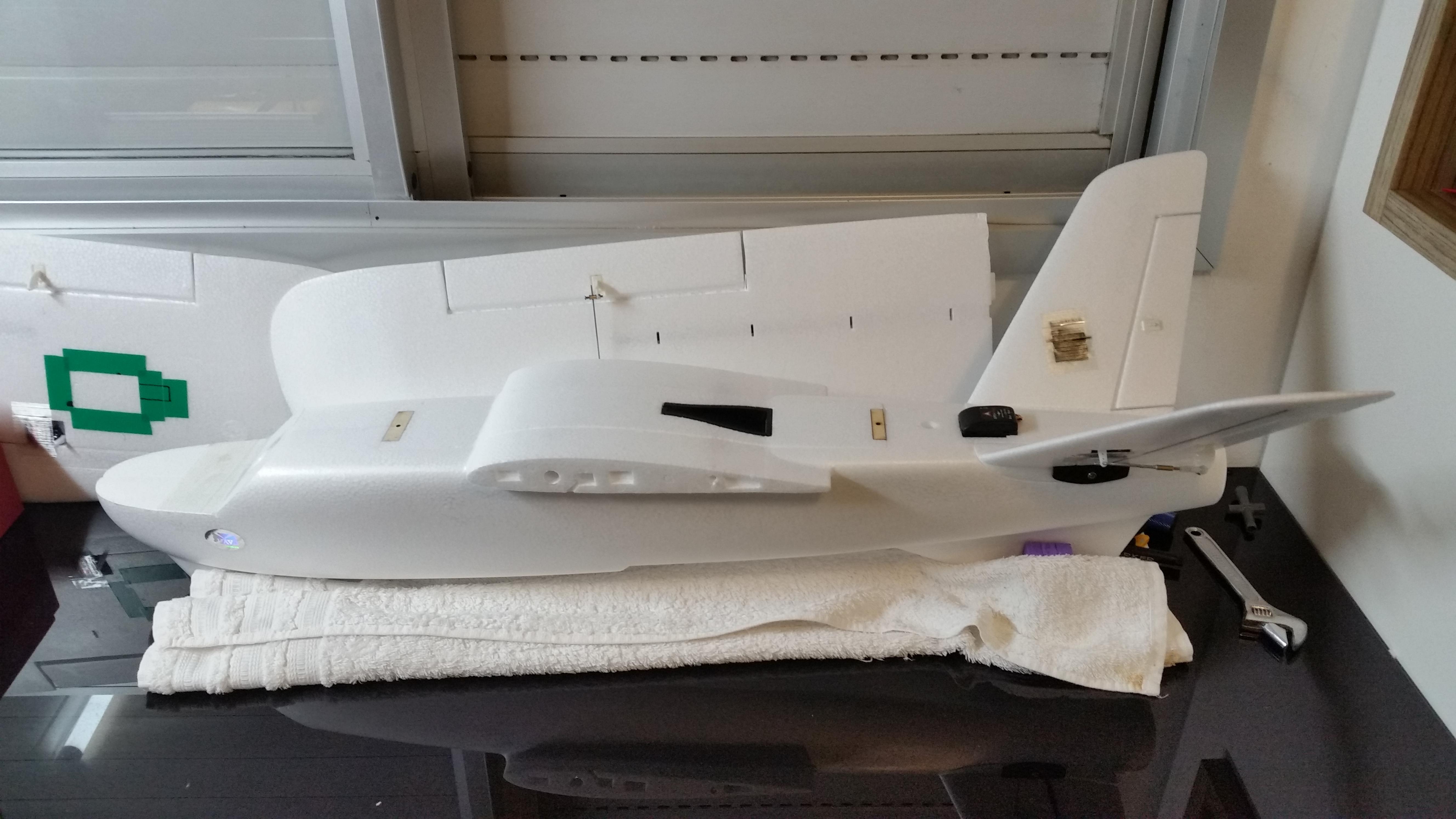

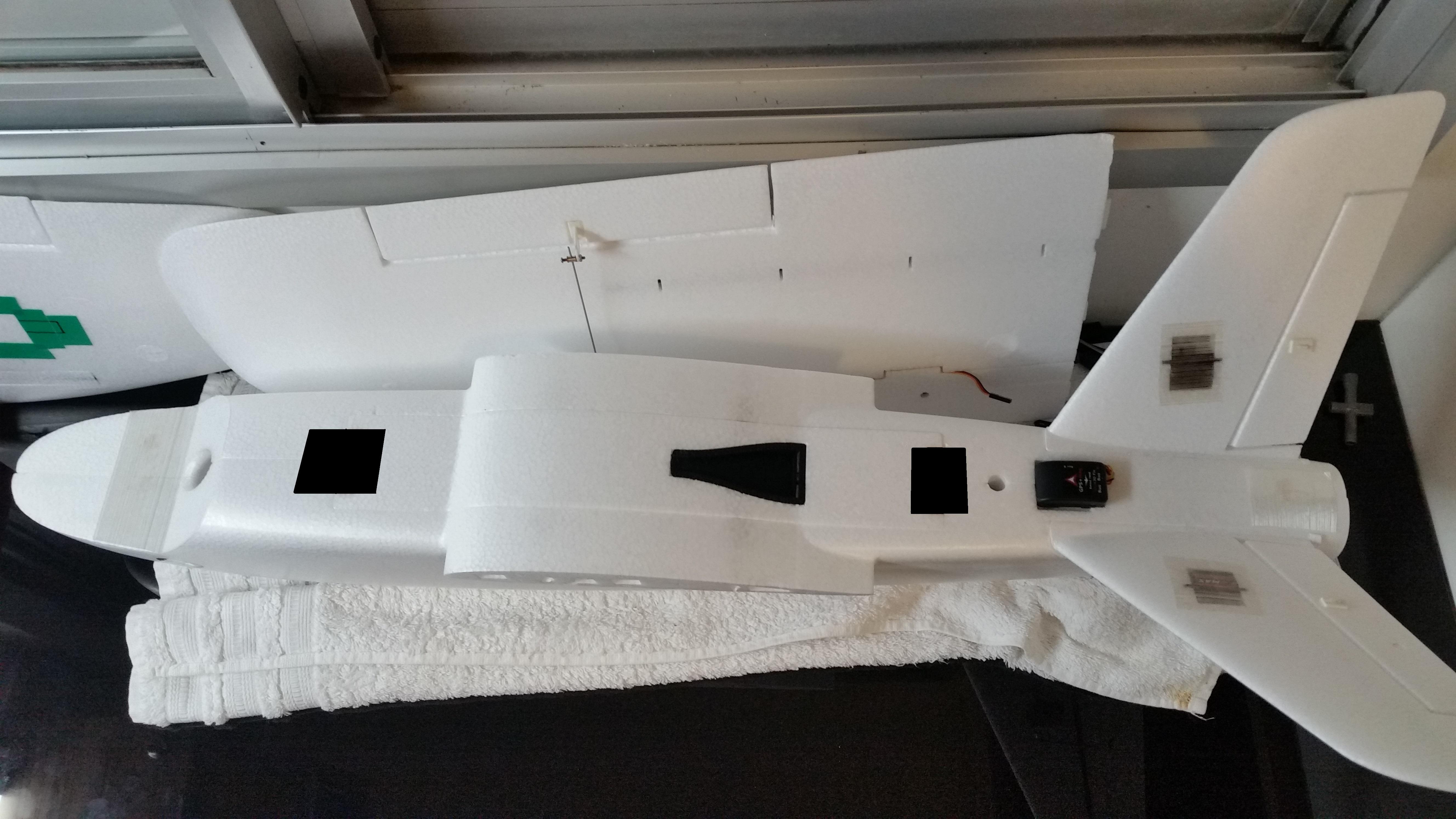

- maio 31, 2017 às 3:45 pm
Ele vai ter os V-Tails removiveis e a tampa de cima será grudada em velcro cfe foto
desmontado
aa

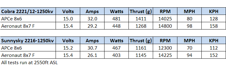

A cor pretendo fazer assim:
Acredito que ao nivel do mar o ar seja mais denso do que era quando o mark_q fez esse teste abaixo
